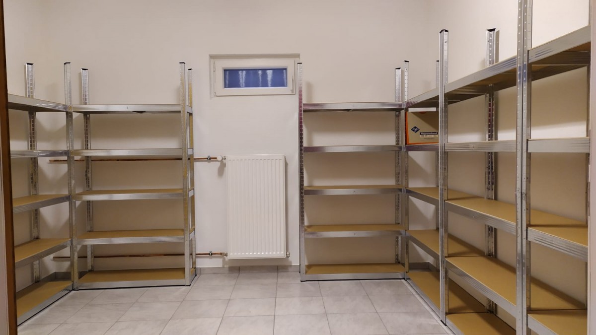

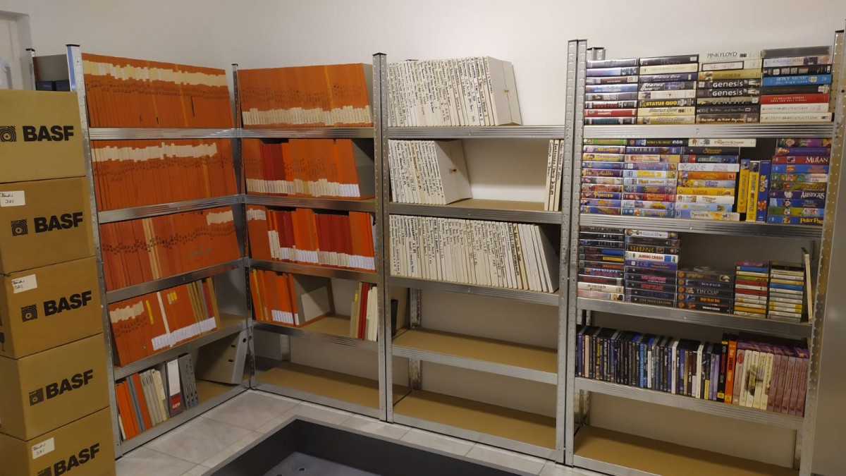

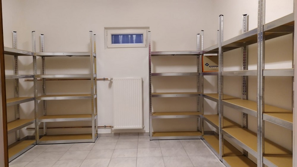

horex1952 Postat Martie 28, 2020 Share Postat Martie 28, 2020 In noua locatie, am un higrometru/termometru, unde incerc sa am o temperatura de 18° si o umiditate de 35%. Vara nu trece de 18° si iarna fixez incalzirea incaperii la 18°. In acest fel incerc sa-mi conserv arhiva cat mai bine. Momentan am numai o parte din benzi, casete si VHS sortate, restul mediilor si aparatele se vor muta in vara. 3 1 Citează Link spre comentariu Distribuie pe alte site-uri More sharing options...

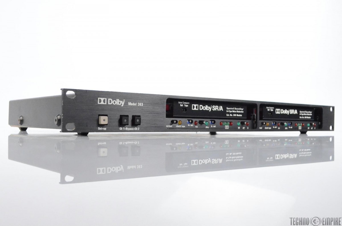

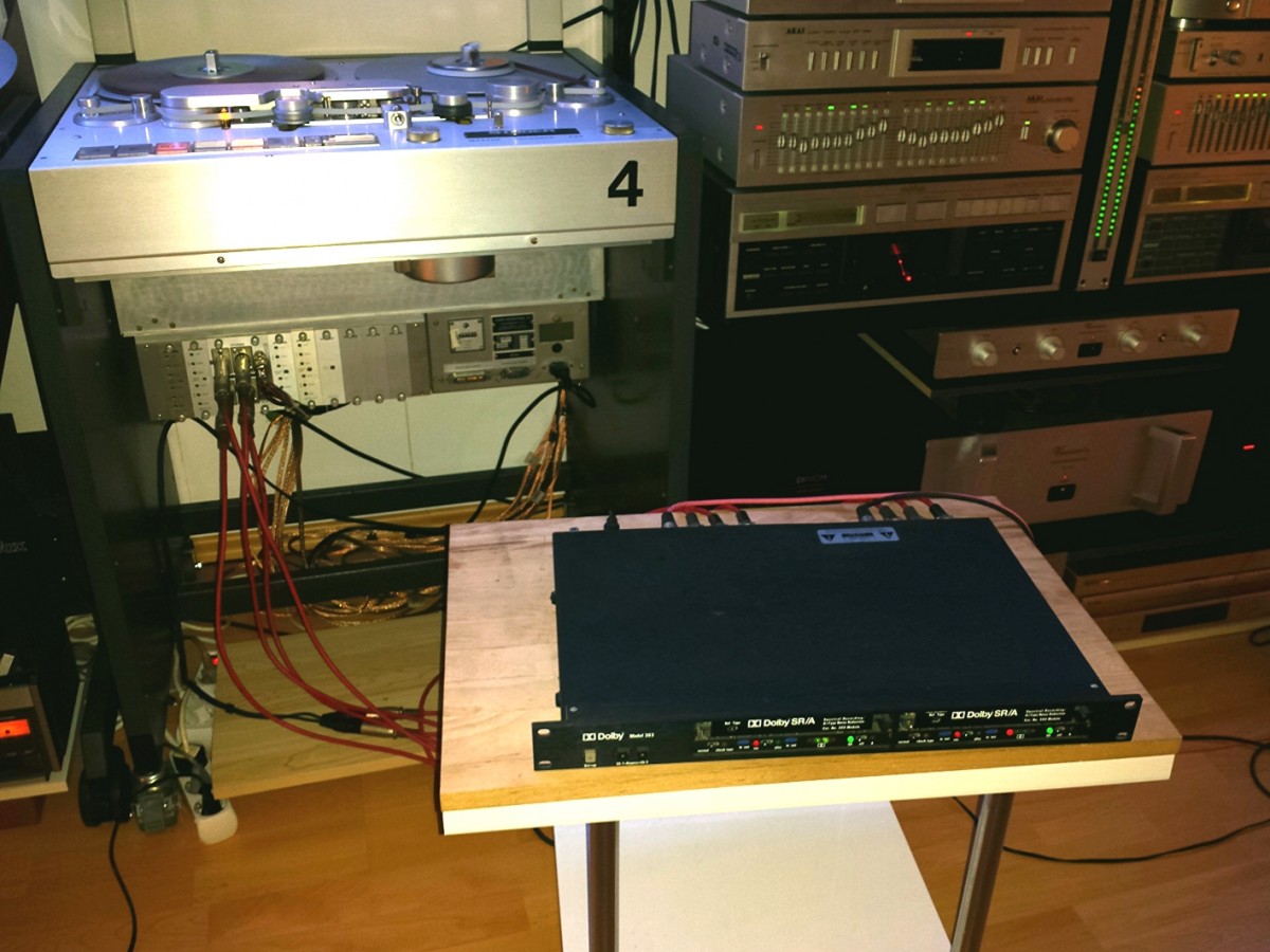

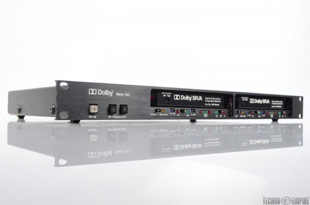

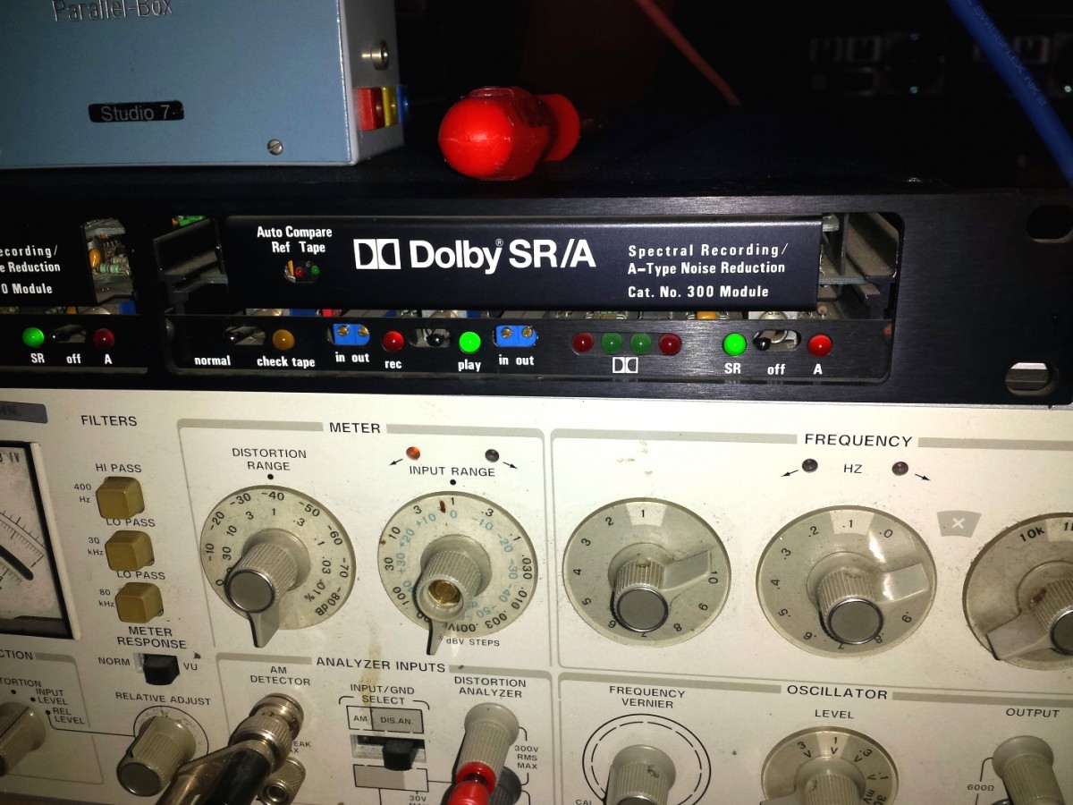

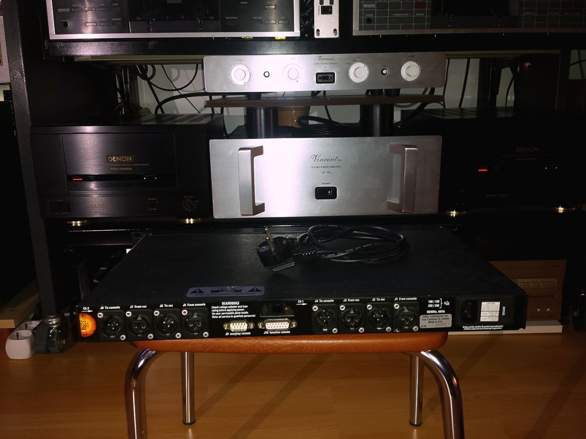

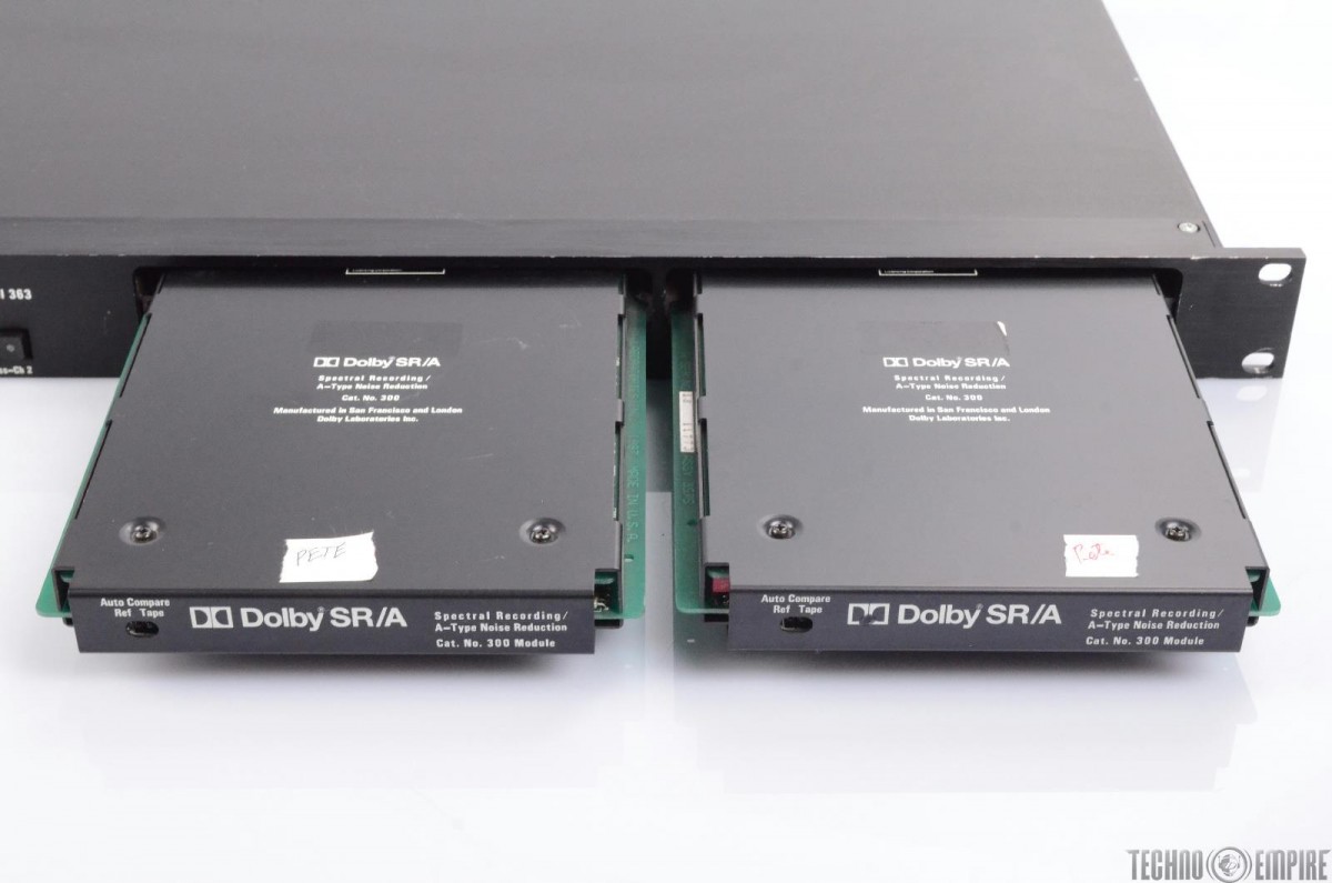

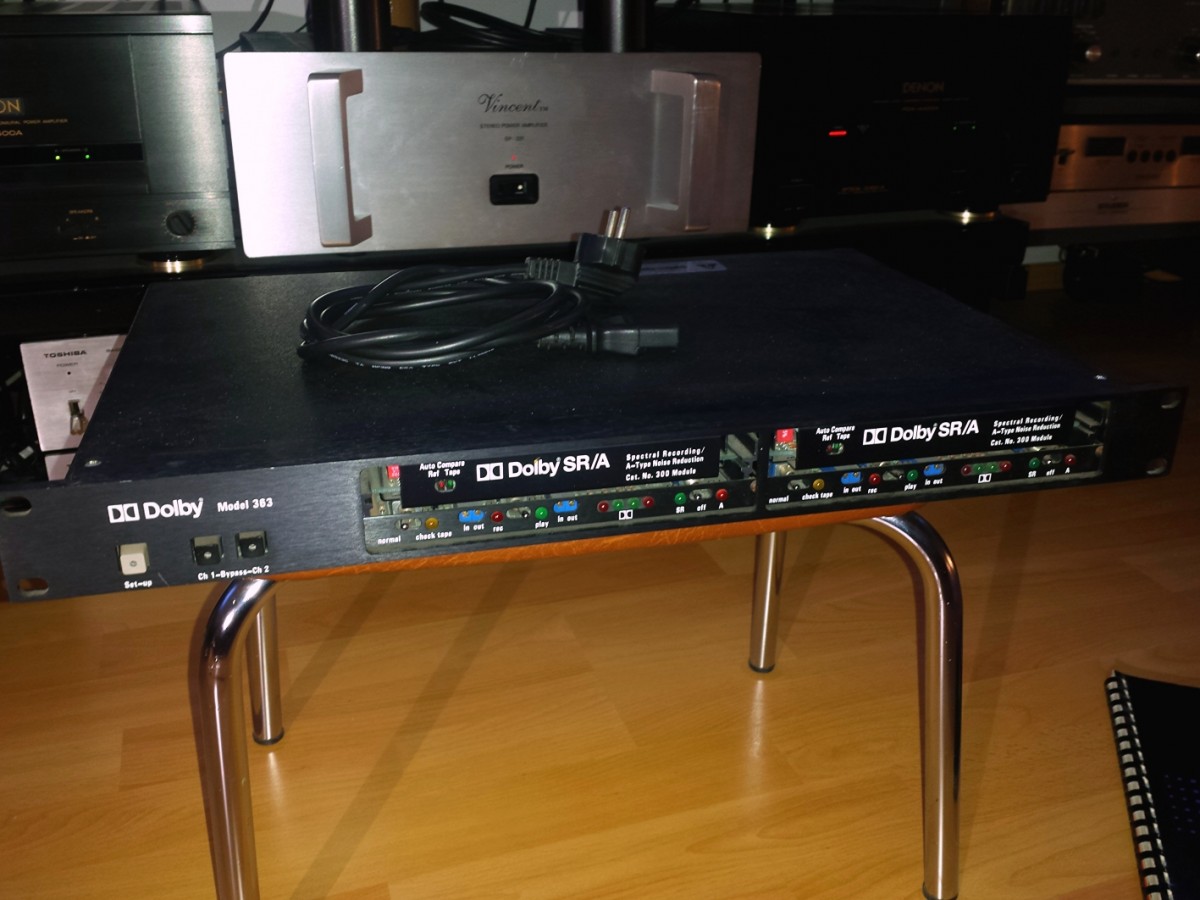

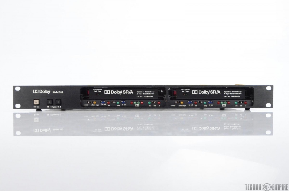

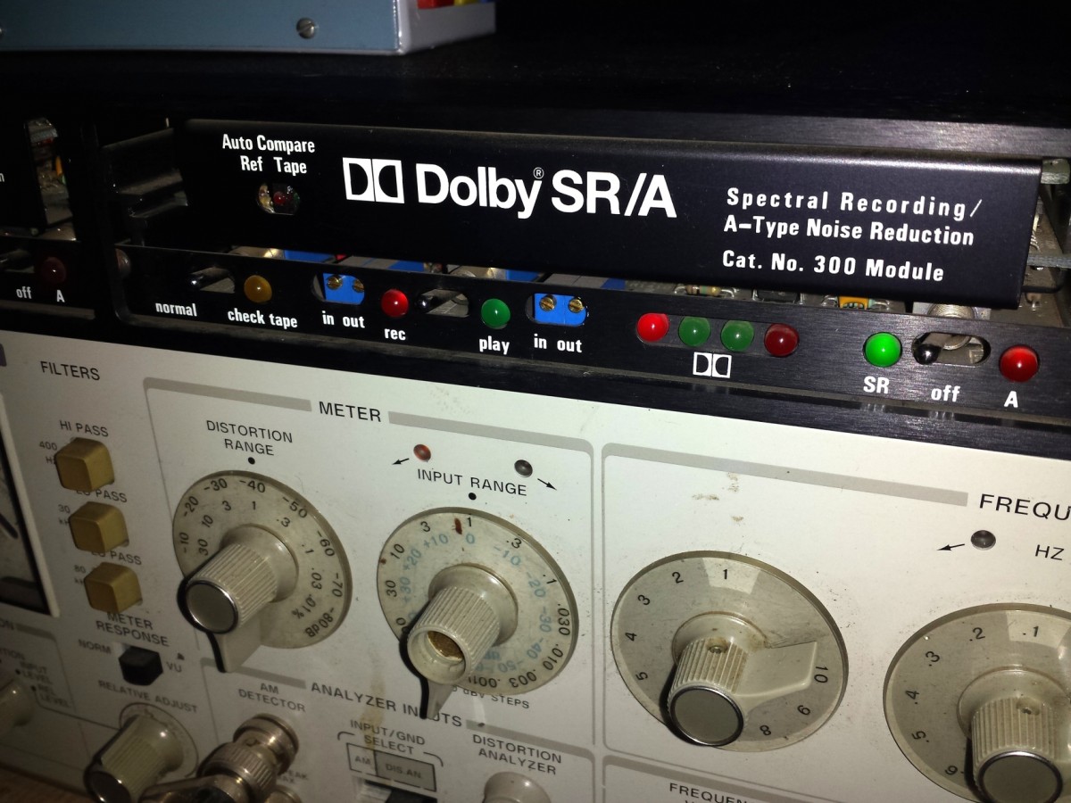

horex1952 Postat Martie 29, 2020 Share Postat Martie 29, 2020 Fiindca tot s-a mai vorbit, asa printre randuri de sistemul Dolby, as dori sa va prezint, modelul Dolby Model 363 SR/A, aparatul cu care redau benzile master din arhiva mea, care sunt inregistrate cu Dolby A sau SR (SR - Spectral Recording). Sistemul Dolby A a fost sistemul mai vechi, folosit in studiouri, SR a fost ultimul sistem de Dolby Professional. Deasemenea am mai experimentat si inregistrarea prin acest system. Mai jos cateva date tehnice in limba engleza: Frequency Response 20 Hz–20 kHz ± l dB encode/decode, at any level Overall Distortion (THD) ≤0.2% at Dolby level Processor Headroom +21 dB above Dolby level Overall Dynamic Range SR: 105 dB, clipping level to CCIR/ARM noise level 105 dB, clipping level to NAB A-weighted noise level 95 dB, clipping level to unweighted noise level, 20 Hz–20 kHz3 Overall Dynamic Range A type 104 dB, clipping level to CCIR/ARM noise level105 dB, clipping level to unweighted noise level, 20 Hz–20 kHz Typical Obtainable Dynamic Range SR: 90–95 dB; A-Type: 75–80 dB; typical at 38 cm/s (15ips) tape speed Matching Between Units ± 1dB at any level and any frequency, 20 Hz–20 kHz Crosstalk <–100 dB, 20 Hz–20 kHz processor off, or encode/decode Signal Delay 6 μs for a single channel, 12 μs for overall encode/decode system Analog Audio Inputs (0 dBr = 0.775 VRMS) XLR connectors, balanced, 20 kΩ; common mode rejection: >55 dB, 50 Hz–10 kHz; maximum input level: +27 dBr balanced, +21 dBr unbalanced; input line levels from –10 dBr to +10 dBr can be adjusted to give Dolby level Built-in Dolby tone and Dolby noise generators for calibration and channel identification Analog Audio Outputs XLR connectors, balanced, 20Ω; output level balance: within 1 dB into symmetrical 600Ωload; output float4 better than –40 dB, 50 Hz–1 kHz; maximum signal level into 600Ω: +26 dBr balanced, +21 dBr unbalanced; output line levels in the range –10 dBr to +10 dBr can be adjusted to give Dolby level 1 1 Citează Link spre comentariu Distribuie pe alte site-uri More sharing options...
horex1952 Postat Martie 29, 2020 Share Postat Martie 29, 2020 Acum 1 oră, horex1952 a spus: Fiindca tot s-a mai vorbit, asa printre randuri de sistemul Dolby, as dori sa va prezint, modelul Dolby Model 363 SR/A, aparatul cu care redau benzile master din arhiva mea, care sunt inregistrate cu Dolby A sau SR (SR - Spectral Recording). Sistemul Dolby A a fost sistemul mai vechi, folosit in studiouri, SR a fost ultimul sistem de Dolby Professional. Deasemenea am mai experimentat si inregistrarea prin acest system. Mai jos cateva date tehnice in limba engleza: Frequency Response 20 Hz–20 kHz ± l dB encode/decode, at any level Overall Distortion (THD) ≤0.2% at Dolby level Processor Headroom +21 dB above Dolby level Overall Dynamic Range SR: 105 dB, clipping level to CCIR/ARM noise level 105 dB, clipping level to NAB A-weighted noise level 95 dB, clipping level to unweighted noise level, 20 Hz–20 kHz3 Overall Dynamic Range A type 104 dB, clipping level to CCIR/ARM noise level105 dB, clipping level to unweighted noise level, 20 Hz–20 kHz Typical Obtainable Dynamic Range SR: 90–95 dB; A-Type: 75–80 dB; typical at 38 cm/s (15ips) tape speed Matching Between Units ± 1dB at any level and any frequency, 20 Hz–20 kHz Crosstalk <–100 dB, 20 Hz–20 kHz processor off, or encode/decode Signal Delay 6 μs for a single channel, 12 μs for overall encode/decode system Analog Audio Inputs (0 dBr = 0.775 VRMS) XLR connectors, balanced, 20 kΩ; common mode rejection: >55 dB, 50 Hz–10 kHz; maximum input level: +27 dBr balanced, +21 dBr unbalanced; input line levels from –10 dBr to +10 dBr can be adjusted to give Dolby level Built-in Dolby tone and Dolby noise generators for calibration and channel identification Analog Audio Outputs XLR connectors, balanced, 20Ω; output level balance: within 1 dB into symmetrical 600Ωload; output float4 better than –40 dB, 50 Hz–1 kHz; maximum signal level into 600Ω: +26 dBr balanced, +21 dBr unbalanced; output line levels in the range –10 dBr to +10 dBr can be adjusted to give Dolby level. Citează Link spre comentariu Distribuie pe alte site-uri More sharing options...
djleco Postat Martie 29, 2020 Share Postat Martie 29, 2020 (editat) Dolby SR, stiu ca este impartit iin structuri pe frecvente (o anumita plaja de frecvente pentru fiecare), de aia ii spune si dolby spectral recording.. N-am avut "bucuria" sa minuiesc asa ceva. Pentru inregistrari pe banda magnetica home use prefer sistemul DBX(II), se inregistreaza superb pe orice suport magnetic, ajuta mult benzile mai puturoase la MOL (Maximum Output Level), impotriva saturarii, avind un raport de compresie expandare excelent. Nu vreau sa va spun cum suna o caseta Maxell XL2S sau o TDK SAXS, ori o TDK Metal trasa cu DBX la un +10+12db DBX level, e nebunie dinamica. Problemele sint insa 2, prima este ca o banda inregistrata cu DBX(II) nu poate fi redata cu absolut niciun alt sistem reducator de zgomot, decit cu DBX(II), altfel sunetul va fi preponderent pe medii, fara bass, " suna spart", cum spun cei in domeniu. Al doilea este ca exista mici atenuari in partea inferioara si superioara audio, cam tot ce este sub 30Hz este puternic atenuat (pe mine asta ma supara strict personal), si ce este peste 18-20kHz este atenuat intr-o mai usoara masura, aici este discutabil fiindca odata cu inaintarea in virsta incepe si scade partea superioara de frecvente audio pe care urechea umana le aude, deci mai putin "important". Eu mai aud (testat) pina le la 15,5kHz-16kHz. Cind aveam 16 ani, auzeam excelent 18kHz. Prin "mai aud", sa se inteleaga ca ce este peste, este bine atenuat fata de 14,5kHz, nu ca nu mai aud deloc. Chestiile astea cu frecventa maxima auzita, depind de la individ la individ. Editat Martie 29, 2020 de djleco Citează Link spre comentariu Distribuie pe alte site-uri More sharing options...

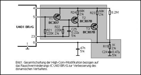

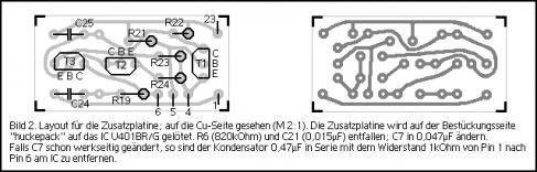

hiatus Postat Martie 30, 2020 Share Postat Martie 30, 2020 (editat) Acum 3 ore, horex1952 a spus: ....Eu personal, prefer sistemul Dolby, am si un sistem HighCom dar e slabutz. Un mic truc pentru a face Hi-Com-ul (I) mai prietenos. Este simplu si merge foarte bine. Nicio urma de pumping sau breathing ... Editat Martie 30, 2020 de hiatus Citează Link spre comentariu Distribuie pe alte site-uri More sharing options...
