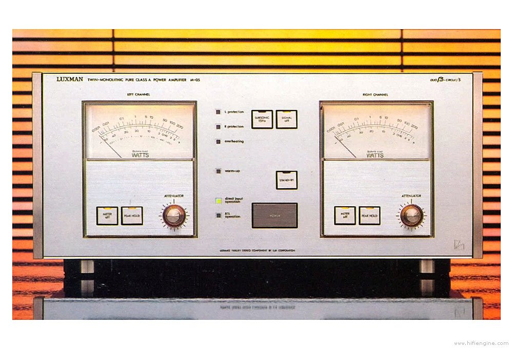

silviu2403 Postat Septembrie 3, 2018 Share Postat Septembrie 3, 2018 Hopa..... Asta este The dream pentru mine... https://www.hifiengine.com/manual_library/luxman/m-05.shtml The top of the line M-05 is a pure class A configuration and sonically ranks with the finest amplifiers in the world. Specifications Power output: 105 watts per channel into 8Ω (stereo), 400W into 8Ω (mono) Frequency response: 10Hz to 100kHz Total harmonic distortion: 0.025% Input sensitivity: 0.75V Signal to noise ratio: 120dB Dimensions: 461 x 210 x 440mm Weight: 39.8kg Citează Link spre comentariu Distribuie pe alte site-uri More sharing options...
silviu2403 Postat Septembrie 3, 2018 Share Postat Septembrie 3, 2018 si o poza.... Citează Link spre comentariu Distribuie pe alte site-uri More sharing options...
